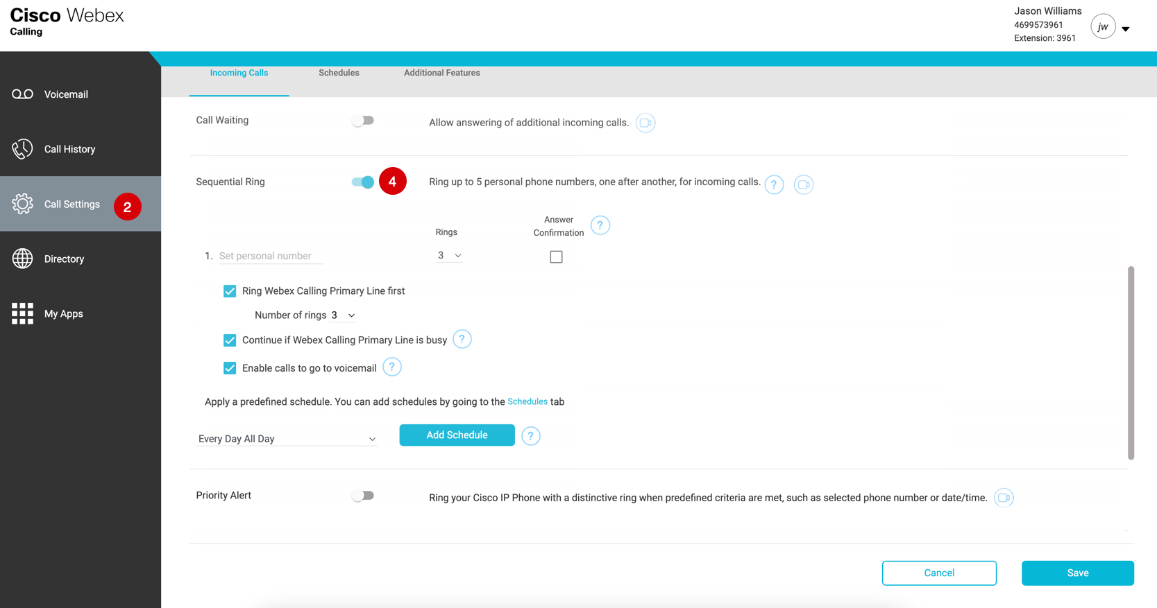

- Log in to the My Phone Next dashboard. You will be brought to the My Phone Next Dashboard with the Voicemail page being the first thing you see.
- Click on the Call Settings Page.
- Find the Sequential Ring setting area.
- Click Enable.
- Enter a list of 10-digit numbers or E.264 International numbers to be rung in order from 1 to 5. After you enter the first valid phone number, a second line will appear to enter phone 2. After each valid number is enter and additional line will be shown up to 5.
- With each line you input, you can also set the number of rings for each device. Select the number of rings from the dropdown menu.
- Check Answer Confirmation for each number you want. Answer Confirmation requires that the called party to press 1 on the keypad to receive the call. If the 1 is not entered, the call continues through the list of sequential numbers. This feature prevents calls from being placed into the voice mail of the alternate sequential numbers.
- Check Ring Base Location first for __ rings, if applicable. When checked, your base location rings first before the other locations are tried. If not checked, your base location will not ring, and Location # 1 is tried first. This also sets the number of rings at your base location before ringing your other locations. The maximum number of rings is 20.
- Check Continue search when I am on a call, if applicable. Calls are sent to your list of alternate locations if the Alert Base Location first for __ rings setting is also checked, and you’re on a call or your phone is unreachable.
- Check Enable caller to skip search and go to voice mail, if applicable. Callers can press # to interrupt the search.
- Click Save.
Note: changing this setting also changes the settings for rings before voice mail and the number of rings for forwarding unanswered calls.
Once your numbers have been entered, you can now create a rule in which this feature will take effect. To do this, select a Pre-Defined Schedule from the drop-down menu and click the Add Schedule button (to create a schedule, see section on creating Schedules). The Apply a Schedule box should appear.
- Make sure your “When” field shows which schedule you currently want to use.
- Select the numbers for this specific alert.
- You can either chose Any Phone Number (to get alerts for all calls) or Select Phone Numbers (to get alerts for specific calls).
- Choose Ring or Don’t Ring.
- Click the Save button.
